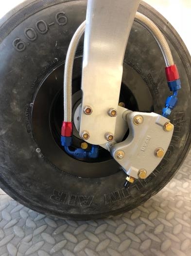

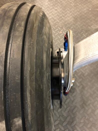

Brief Description:  Brake line fabrication
Figuring out how to connect the gun-drilled brake line to the brake caliper. Ive seen some pictures where the hose went below the caliper, but it seemed to get in the way of the bleed nipple, and risks getting hit by rocks. I elected to try the 'over the top' route using a variety of AN4 fittings connecting to the NPT 1/8 holes in the Grove gear. The loop clears the undercarriage leg nicely, remains inside the wheel pants, and I can support it with a P clamp when the pant bracket is fitted later. I can remove the caliper and bleed the brakes without having to remove the wheel pants completely.
Up an over route? better to keep brake lines inside the wheel pants and away from the ground
Plenty of clearance
Plenty of clearance
