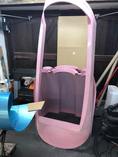

New Fastback kit and cowling arrived from Showplanes this week, so Ive got some work to do at last!

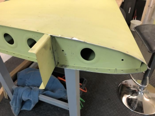

First job was to pull the lower front rib out after removing all of the rivets, then cut off a 5 degree wedge from in front of the spar, to the leading edge. Tight squeeze getting the rib back in,Match drilling, cleaning edges and dimpling the skin ready for new rivets.
All completed, sanded down smooth, and ready for touching up the primer.

Fastback kit arrived!
VS trimmed for fastback
Getting the lower rib inside is fiddly!
