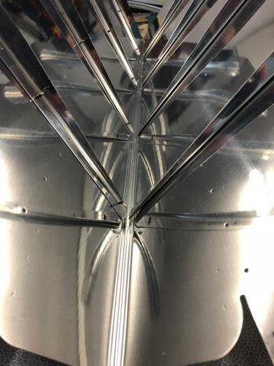

Date:  4-23-2018
Number of Hours:  7.00
Brief Description:  Elevators started
Started on the stiffeners for the elevators. The instructions for trimming some of the port stiffeners were a bit vague, as they show distances from the second most aft skin holes... which aren't there originally and have to be match drilled to the skin first.
It would have been easier to say 'trim 3/8th inch from the back of these three stiffeners...
some stiffeners need trimming
