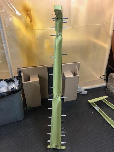

Brief Description:  Rudder Rivetting
Rivetted the rudder skeleton, installed rudder hinges, clecoed rudder skin back on. Re-did few rivets in the most awkward place. Contemplated buying a rivet shaver, looked at the price and decided to drill them out! All done without damaging the skin... it's awfully thin! The small tungsten bucking bar is great.

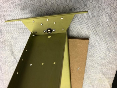

More rivets than shown on plan!

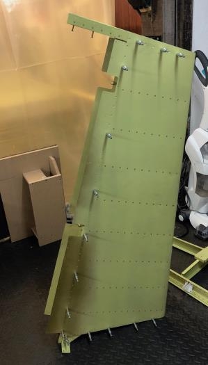

Rudder skin back on
Rudder skin back on
