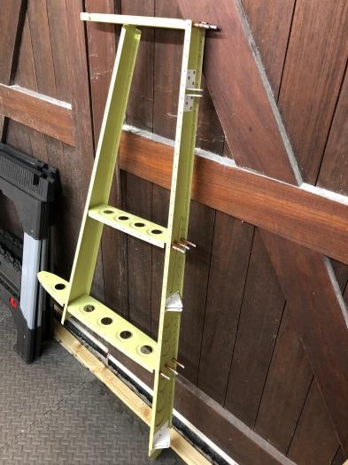

Brief Description:  HS skeleton assembled
Productive day!
Rivetted the HS front spar, getting loads of practice at bucking universal rivets. All assembled well, with just a few rivets changed due to small 'smileys'. I've read that this is a cosmetic problem, and that they can be left (and probably less chance of buggering things up) but I wasnt happy... so out they came.

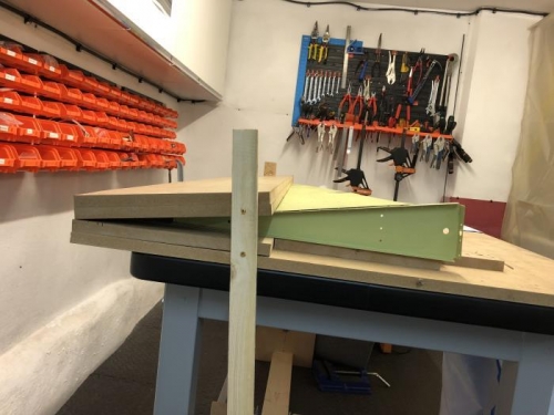

Then the bit I was really concerned with... bending the leading edge. I laminated thick MDF and used four big hinges to create the bending break, and it worked well. I clecoed the lower skin to the table, bent the edge, and it all worked!
VS skeleton assembled
Bending break from MDF
