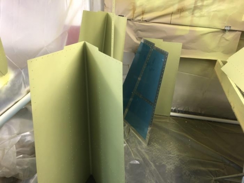

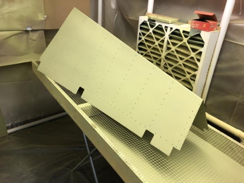

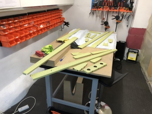

2 pack etch primer, followed by 2 pack epoxy primer. Figured out the spray gun air pressure, paint viscosity so much better result and feeling happier about the process.
Having a better understanding of the paint prep, drying times etc meant the whole process felt much less rushed than the first attempt.
Not sure about the colour, but I guess its better than corrosion
Rudder skin primed inside and out
other skins primed inside only
