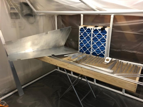

All rudder components trial fitted, dismantled and prepped for priming. Tried dimpling the holes near the trailing edge, but the DRDD2 was rubbish at getting to them. Made a dimple die to reach them.
Degreased rudder components and a few other bits, washed them all with de-ionised water, and put them in the spray booth ready for painting tomorrow
Ready for etch prime tomorrow!
