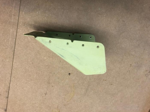

Made the lower rudder 'box' today. Made a jig to match the lower rudder skin drill holes and used this to mark out the cut line to avoid 'edge issues' that many builders seem to have experienced.
All of the angles worked out well, so really pleased
Key is to cut on the correct side of the central hole!
