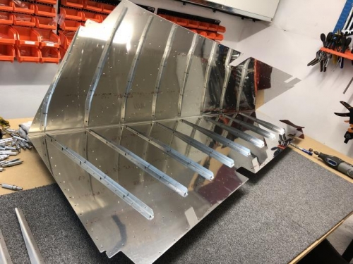

VS progress today. Match drilled, dismantled and deburred, skeleton dimpled. Still waiting for the springback dimple dies for the skins..
Rear spar machune countersunk and it fits beautifully to the rear spar. Deburred, scotchbrighted, degreased and ready for priming. There will be a big batch of parts ready for priming soon!

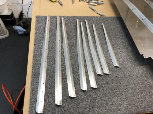

Decided to make a start on the rudder; made the skin stiffeners, clecoed and match drilled them all, then the usual process of teardown, deburr, edge, scotchbright.
I love making skin stiffeners... said no-one... ever!
They look good when in place though!
