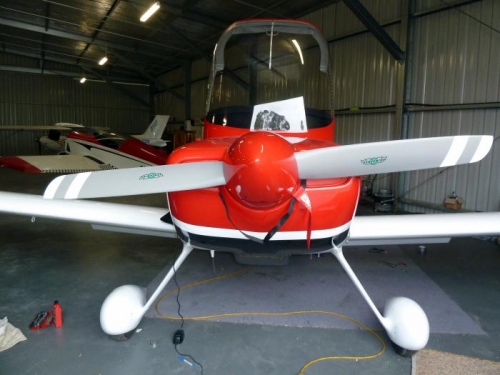

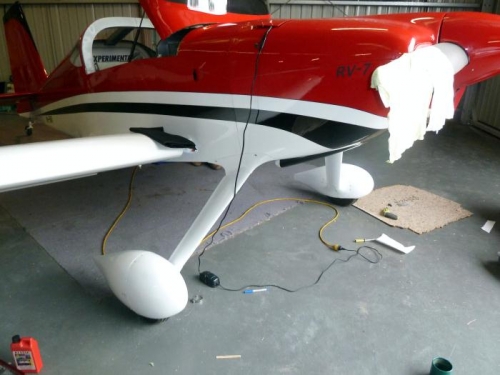

Looks much nicer with its gear leg fairings and pants on
Head on view
Head on view
