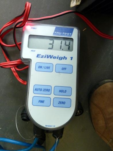

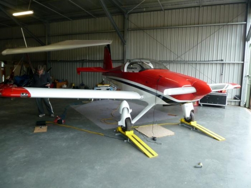

Weight and Balance
The total weight in kilograms was 498.6kg
The arms that we measured for the wheels were;
Weight Arm Moment
Left 513.92 69.0" 35460
Right 513.92 69.0" 35460
Tail 69.0 249.6" 17222
Total 1096.84 88142
Empty CofG = 88142/1096.84 = 80.36"
CofG range 78.7" --> 86.82"
Including the wheel spats in the final weight
