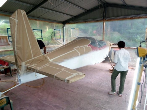

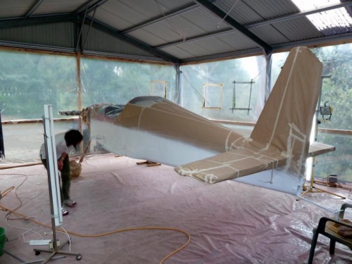

Brief Description:  1. Masked up for painting white
This morning it took us about 4 hours to get a symetrical curve on both side of the fuselage with fine-line tape before finally being able to mask the top of the fuse for painting.
After a bite to eat I shot 3 coats of white, two lite and one normal coat allowing about 15-20 minutes between coats to give a very nice shinny finish.
AM inspecting our work
More inspecting
More inspecting
Right side inspection
