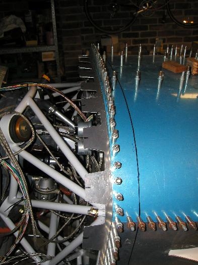

Brief Description:  Replaced top hinge, changing to camlocs
I tired really hard to make the hinge idea work over the curved area of the top turtle deck and finally gave up, I will still use hinges on the rest of the cowl but this curved surface just made it too difficult to insert and remove the hinge.
I have camloc's on order from Aircraft spruce, they should turn up in about 6-7 days, so I will focus on cutting the instrument panel while I wait for these part to turn up.
0.063 strip of aluminium to replace the hinge
