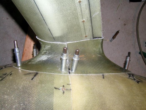

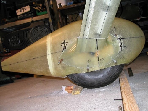

Lucky this is fiberglass, for some reason I had more trouble fititng the left set fo fairings than the right side, so now I have a few extra holes in the left wheel spat where I had things clecoed into place before relocating for a better fit. These holes will disappear once I bond the intersection fairings to the wheel spats.

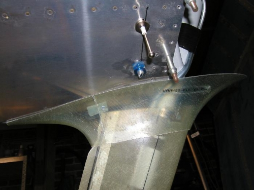

Phew, this bit of the fiberglass work is nearly done, I just need to install some nut-serts (?) into the fuselage skins to locate the top intersection fairings as there is little to no room to install nut plates into the bottom area of the fuselage.
Left wheel spat intersection fairing installed
Side view before trimming the bottom rear of the gear leg for a better fit
Looking left and under the fuselage at the top intersection faiirng
