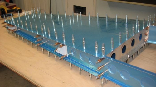

Brief Description:  Clecoed vertical stab
Clecoed vertical stab, i skipped every other hole just to make sure everything lines up.
drilled holes for the skin with number 40 drill bit, ribs and remaining parts with number
30. since drill bits do not provide a true size, the hole ends up slightly larger, i decided to purchase
#30, #40 reemers.

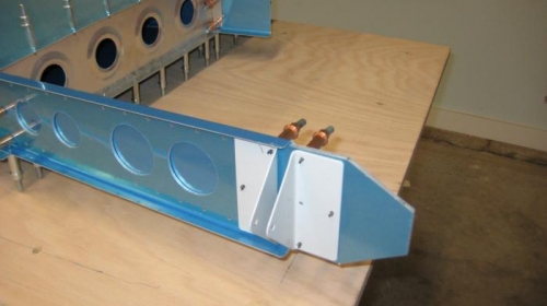

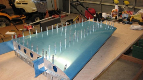

All parts clecoed
All parts clecoed
Perfect fit
Perfect fit
Vertical Stab
Vertical Stab
