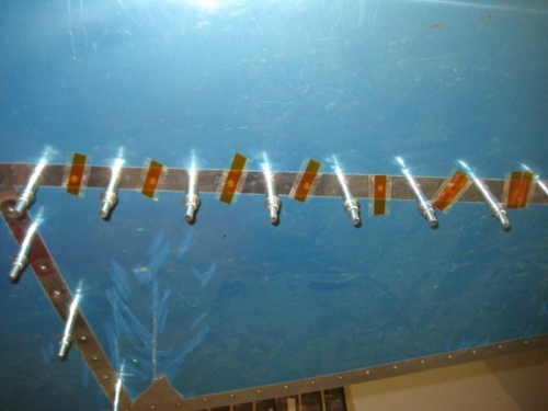

Brief Description:  Riveting Skin
The rivet tape was placed over the rivets before using the rivet gun. Adding the tape helps eliminate the marks that the pneumatic rivet gun leaves on the skin. The rive tapet is a little expensive, but I think it's really worth it considering the cost of the overall project. .
Tape over rivets
Tape over rivets

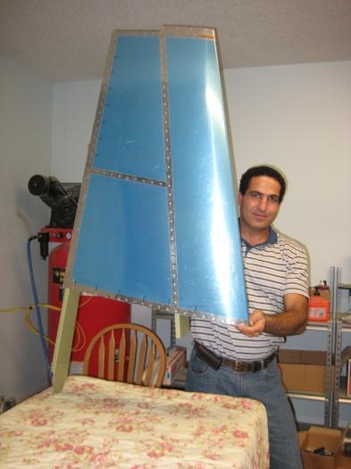

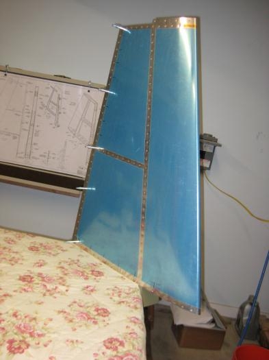

Finished vertical stabilizer
