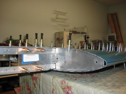

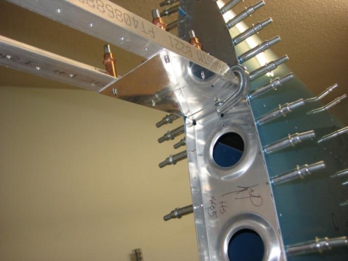

On photo 2, i will leave the upper left section of the HS open to gain access to the rivets, this way, my HS will be completed with all solid rivets.
the two Ribs in the malfunction Junction will be rivited last.lets see if this works, i will keep you posted.
