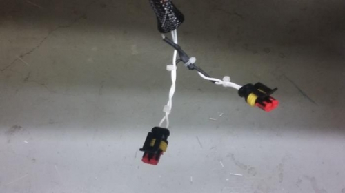

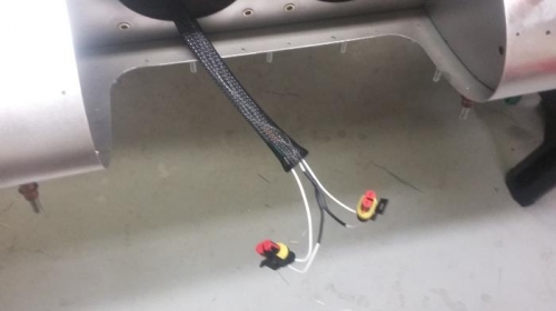

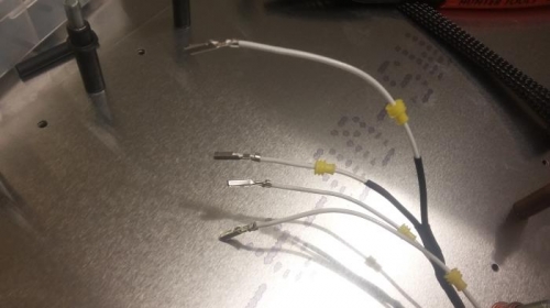

I soldered a branch to the ground wire, covered with heat shrink and crimped contacts on all 4 wire leads. I then installed a protective sleeve, inserted the contacts into the connectors, inserted the wire seals and tie-wrapped the individual pairs.
soldered gnd wire branch & crimped contacts
installed sleeve and connectors
tie-wrapped
