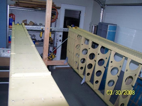

Re-riveted ribs to Spars

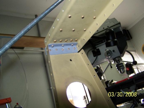

Fab’ed and riveted reinforcement for end rib
Drilled out ribs and re-riveted to spars with shop head on spar

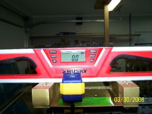

Leveled main spars on wing stand
