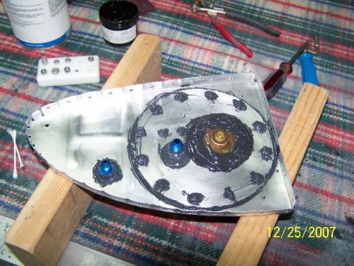

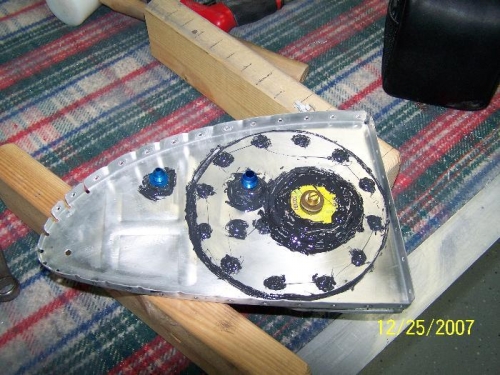

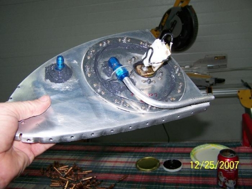

LONG DAY
Drilled for cover plates & Sender, deburred holes, riveted platenut for cover plate and sender.
installed (with pro seal) cover plates and senders
installed vent tubes and fab'ed & installed fuel pick up lines.
