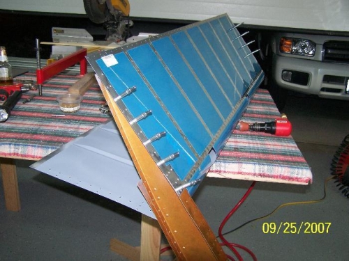

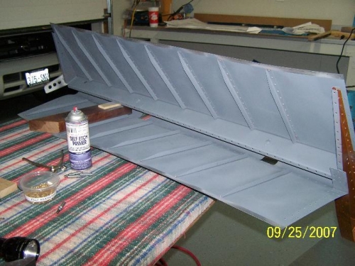

Right El
Pre-assembled
Drilled all holes
Deburred and dimpled all parts
Alodined and primed spar, ribs and stiffeners
Riveted spar doublers, platenuts, and counter balance
