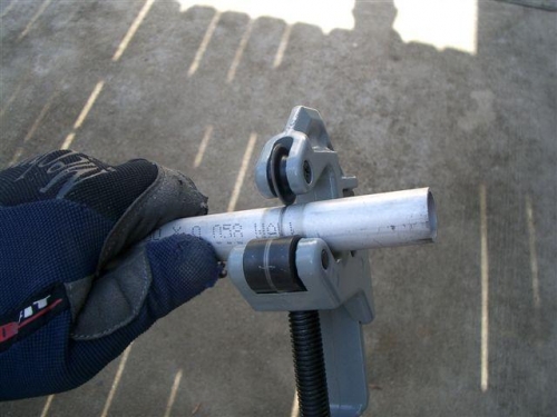

Brief Description:  Forward Elevator Pushrod

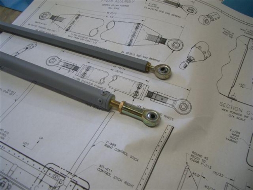

Primed and riveted the forward pushrod. It came out great.Moved on to the rear pushrod. Again I used the tubing cutter to remove several inches. This one is a bit different. There is a cap with a threaded stud that fits in the ends of the tubes and then the rod end is a female threaded piece that screws onto this cap.Next I setup the drill press to drill the rivet holes. Used a paper template again to mark the hole locations and drilled away. Primed and riveted.Moved on to the control column pushrod. This was just priming and screwing the rod ends in place with the proper nuts. Locked down the nuts to the required length of 18 and 7/8 inches. Pushrods done!
