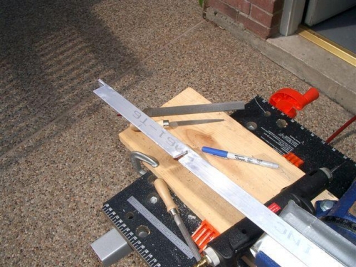

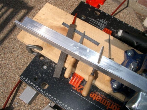

Brief Description:  Longerons
Time to notch the rear longerons and cut the notch for the HS brackets in the fuse tailcone. I used the empennage deckplate to mark the notch areas at the back of the longerons. Cut these areas out with a pnuematic hack saw. Filed em down and I think they are ready for the downward bend at the 28 1/4 mark.
