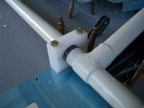

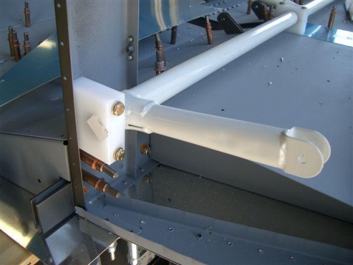

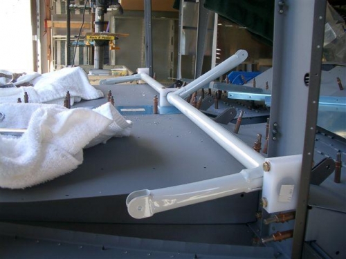

Drilled bolt holes into the center bearing block that sets to the left of the control rod. This bearing sits in the non powdercoated area of the rod. To get it to fit you then cut it in half.Dug out the bearing blocks I drilled back with making the 705 bulkhead. I tapped these onto the flap actuator weldment and bolted them in place. Next I put the top half on the center bearing block and inserted the bolts. Everything fits perfect.
