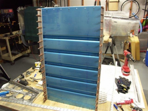

Date:  9-8-2005
Number of Hours:  3.00
Brief Description:  Parts Fabrication - Seat Backs
Continued with seat back construction. I marked the drill patterns on the side angles and drilled with the drill press. I then used the drilled holes for backdrilling into the seatbacks. Next I used the cutoff saw on the hinges. Then I marked the rivet pattern and drilled on the press.
