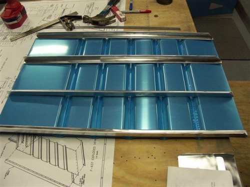

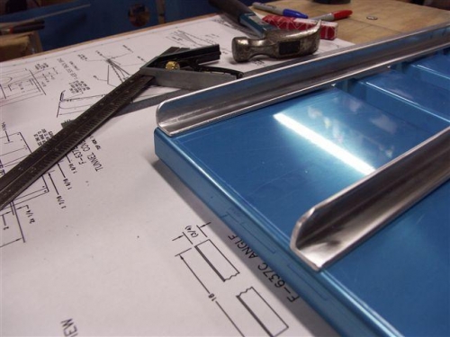

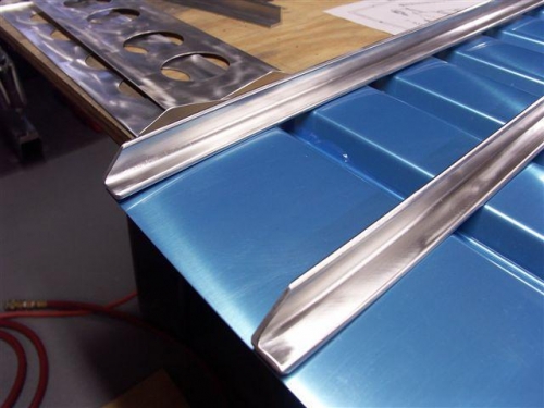

Brief Description:  Parts Fabrication - Seat Backs
Riveted the tunnel cover top plate to the side channels.Next I used the chop saw to cut the 4 angle braces for the set backs. Cut the bottom 45 degree angles and rounded off the tops to a 3/8 radius using a dime as a template. I ground everything smooth with the scotchbrite wheel and polished up with the die grinder.
