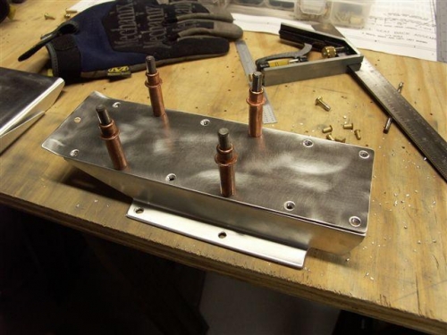

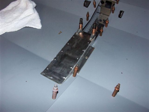

Continued work on the tunnel cover. I screwed the side brackets to the left and right side of the floor panels and match drilled the cover in place. Dimpled the cover plate and counter sunk the side brackets. Ready to rivet.
