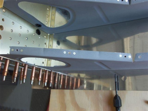

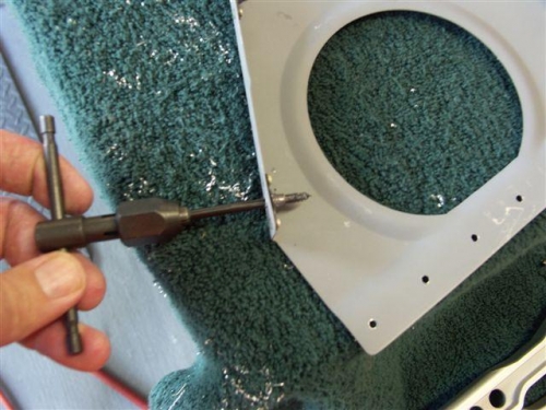

I removed the seat pans from the center fuselage and added the 6 platenuts to the outboard seat ribs. Also had to grind off a bit of the outboard seatpans to get the proper edge clearance from the outboard ribs.
