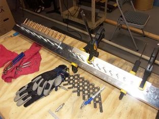

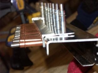

F-705 Bulkhead
Continued on with the top plates. I used the shim to backdrill by clamping it down on the top plate. Also used the shim to backdrill the angle bracket that gets riveted to the back edge.
