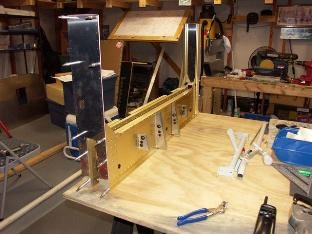

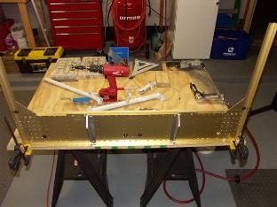

Brief Description:  F-704 Bulkhead
Fabricated flap contol braces. Mounted braces to aft bulkhead and test fit flap control pieces. Moved on to forwad bulkhead. Riveted both side braces to bulkhead. Riveted and bolted panel braces into place. Clecoed side panels to both bulkheads. Ready to move onto F-705 bulkhead.
