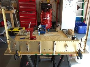

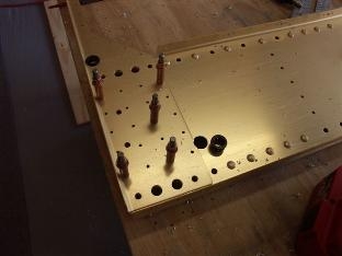

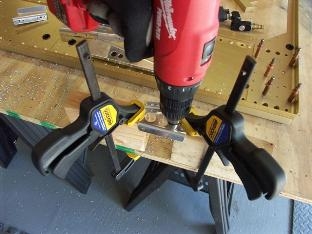

F-704 Bulkhead
Final drilled the F704 C and D brackets to the main bulk head pieces. Used a unibit to enlarge the holes requiring snap bushings. Riveted nut plates to floor brackets ad stiffeners.
