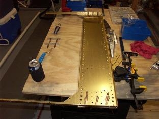

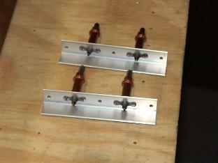

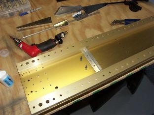

Brief Description:  F-704 Bulkhead
Completed the replacement rivets on the firewall. Moving on to the F-704 bulkhead. Cut the web stiffeners out of 3/4 inch angle. Drilled the holes for the nutplates. Countersunk the nutplate rivet holes. Clecoed the side braces onto the forward and aft center bulkhead pieces.
