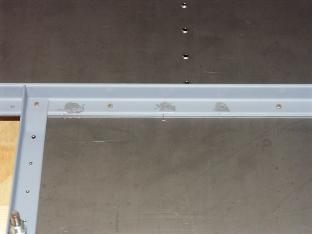

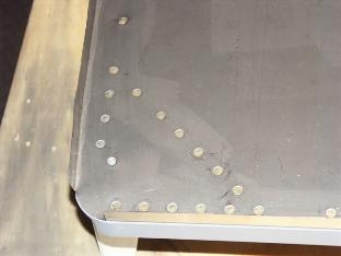

Firewall
Riveted all firewall rivets. Had to drill some out that did not come out flush. On 3 along the top row the drilled out holes are too big so I mixed up some JB Weld and filed the angle. Will redrill tomorrow and complete the riveting.
