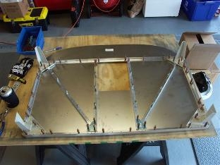

Brief Description:  Firewall

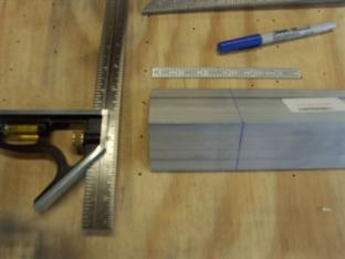

Fabricated the F-601-J's from stock angle. Cut them to length. Cut to spec measurments and then used file and scotch wheel to clean up the edges. Moved on to firewall. Clecoed stiffeners, gussets, and engine mounts to firewall. ready to start the drilling.
