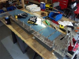

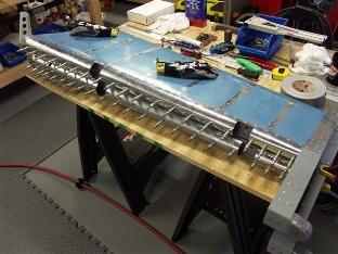

Brief Description:  Elevator Completion

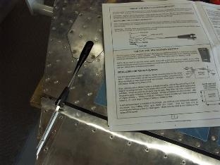

Used 3/4 inch PVC pipe to roll the leading edges of both elevators. Removed the hinge pin to allow riveting of top hinge of trim tab. Cut the electric trim rod and installed clevis's. Centered the trim servo with a 9 volt battery before installing rod.
