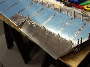

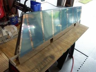

Brief Description:  Elevator Completion

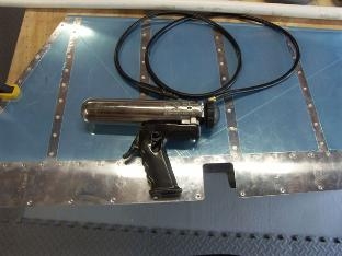

Finishing up the elevators. Used my new proseal gun to inject proseal into the trailing edges of both elevators. Proseal is put into he trailing edge at the point of contact of upper and lower stiffeners. Final riveted all edges except for the upper trim tab hinge in the left elevator.
