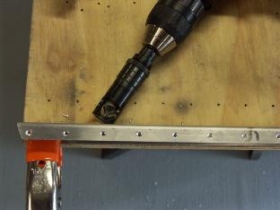

Clecoed left elevator frame together. Machine dimpled the trailing edge spar. Dimpled the other pieces with the squeezer. Clecoed the skin onto the frame and final drilled the holes I missed earlier. Deburred and dimpled the counterweight skin. Primed the frame pieces and am ready to dimple the frame.
