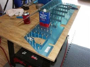

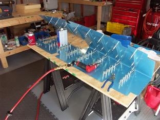

Continued on with work on stiffeners for right and left elevator. I clecoed to the skins and final drilled all holes with #40 bit. Removed stiffeners and started the deburr process.
