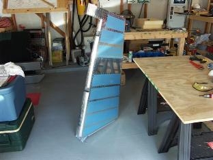

Number of Hours:  1.00
Brief Description:  Completed rudder
The epoxy has cured. I installed rivets in the rudder trailing edge. I used tape to hold them in place so I could use the backrivet plate to do a double flush head from the shop head side. I started out setting every 10th rivet half way. Then every 5th and then every other one. Then I final set each one. The edge came out good and straight. Next I used a 3/4 inch piece of PVC pipe to precurl the rudder leading edge. After the precurl I used pop rivets to close up the leading edge. RUDDER COMPLETE..... Time to move on to the elevators!
