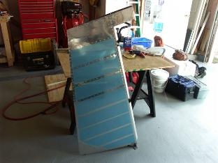

Brief Description:  Rudder
Riveted rudder skins to frame. I did not have any proseal so opted for the slow cure epoxy method. I mixed up the epoxy and applied to the meet points of the rudder stiffeners. Also applied it to the trailing edge wedge. I cleaned out all rivet holes and clecoed every 5 rivets and set aside to cure.
