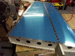

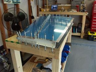

Riveted the right side of the VS. The first 3 rivets came out too thin on the shop head. I dilled out each rivet and tried lowering the pressure to 40lbs. This worked much better. I only had to drill out 1 more bad rivet.
