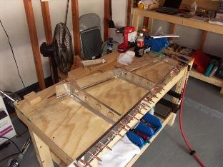

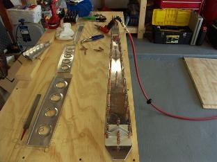

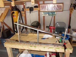

Date:  6-12-2004
Brief Description:  Vertical Stabilizer Main Spar
Started work on the VS due to not receiving the bad replacement rib from Van's yet. Used file to break the edges on the alum. doubler. Clecoed the doubler to the spar and cleoced and final drilled holes in rear spar. Installed and drilled hinges in the rear spar. Continued on to match drill and cleco the rest of the VS frame.
