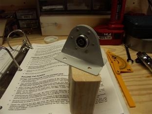

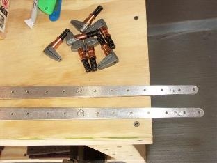

Brief Description:  Rear Spar
Continured work on the HS-609PP's. Used belt sander to get smooth shiney finish. Also radiused the corners and ends. Final drilled all holes and clecoed HS-609PP's into HS-609PP. Also installed bearing into HS-411BPP brackets, drilled and clecoed to rear spar.
