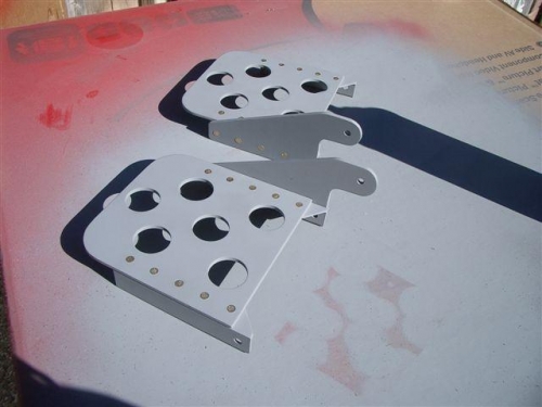

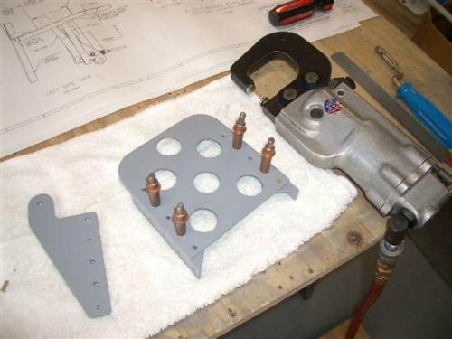

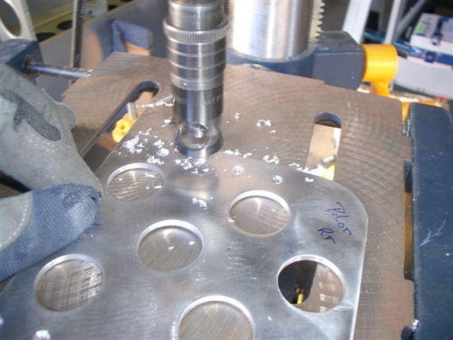

Brief Description:  Rudder Pedals
Today is a perfect day for flying but! I drilled the side plates onto the pedals. Enlarged the bottom side holes to 3/16 to take the install bolts. Counter sunk all the rivet holes on the press. All of the rivets are flush on the pedals and the sides which give a clean look.Next I primed the pieces and once dry clecoed together. I used my pneumatic rivet squeezer to complete the pedals.Time to jib up the rudder arms to get these rigged up with the master cylinders.
