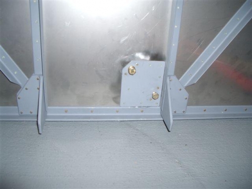

Brief Description:  Fuel Pump Doubler
I countersunk the doubler and primed it. Match drilled the holes in the firewall.STAINLESS Sux! When I went to drill the 1/4 inch holes I burned up 2 bits. In retrospect I should have drilled a small pilot hole and then worked my way up. Riveted it in place with the nutplates. Its ready for the fuel pump.
