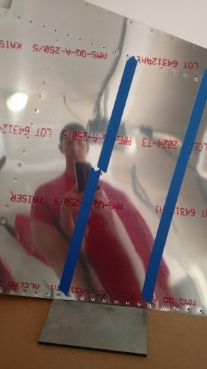

I "back riveted" the stiffeners to the rudder. This means I put the rivet gun to the inside of the skin, against the "shop head" of the rivet, while a metal plate sat on the outside of the skin, on the flush surface of the machined head.

Taping over the manufactured heads, to keep the rivets in place.

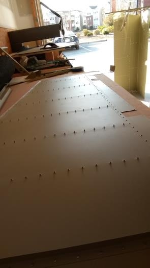

Rivet tails poking through skin after taping

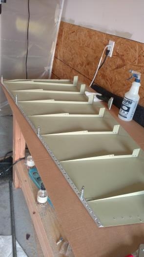

Placed stiffeners onto skin and riveted
