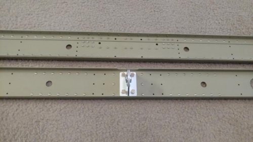

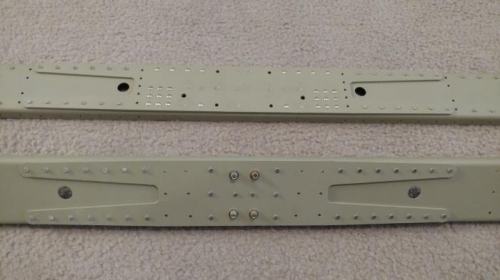

Today I riveted the stiffeners to the two horizontal stabilizer (HS) spars. Most of the prep work was completed prior to priming, but I ran into a few issues:
The flush rivets didn't sit all the way in - most likely due to primer filling some of the hole - and so I had to re-countersink every flush rivet hole to get the rivets to sit flush.
I ran out of a certain length of rivet. Actually, I had just one rivet remaining. I took that rivet, lined it up with the next longer size, marked the longer rivets, and cut them to size. I then took the newly cut tips to my scotchbrite grinding wheel to shave off the sharp edges. I now had more correctly sized rivets!
The four bolts that hold the center elevator bracket have a torque specification. I have a torque wrench that I haven't used yet, so I looked up the specs. For this bolt, I need 28 inch-pounds of torque. I set the wrench, then found that the small socket size on it will not take any socket heads in my toolbox. The bolts are sitting loosely until I get an adapter for my torque wrench.
All the rivets in these spars could be squeezed instead of using the pneumatic rivet gun, so I brought them inside and squeezed them all.
Stiffener plates riveted. Aft spar (bottom), front spar (top)

Front spar with stringers (top), aft spar with elevator bracket (bottom)

Front spar (left), Aft spar (right)
