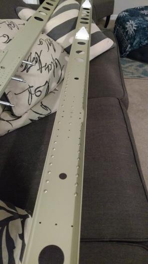

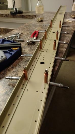

Afterwards, I brought the two HS spars to my apartment and began assemling and riveting. I was able to completely finish attaching the aft spar stiffener and elevator brackets. The front spar is the one with the more complex "H" shaped stiffener and the long extruded "L" shaped stringers on the inside of the channels.
Front Spar with channel stiffeners
Front Spar turned over (on left), Rear Spar with white elevator brackets (Right)
The spars are bigger than my couch!
