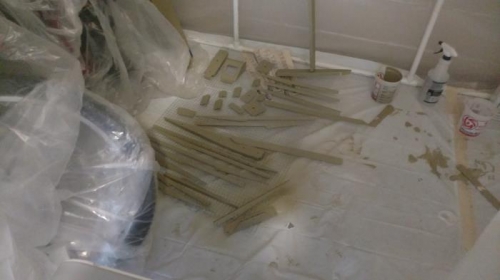

The spray gun has an issue. It has a dual-pull trigger. Pull a little bit for first stage, and air only flows. Pull more for second stage, and air + primer flows. There's a pressure gauge at the gun that SHOULD show 30 psi with just air, and 20 psi with air and liquid at the second stage pull.
However, when any airflow goes, the gauge immediately reads zero. Instant drop. I already returned and swapped one gun via main with Amazon, this second gun is doing the same thing. I'm not sure why. Maybe the airflow in cubic feet per minute (CFM) is too low? Maybe my air hose is too narrow? Or maybe, as was suggested by the 3M Rep... maybe this gun was part of a bad batch?
The primer job looked splotchy at best because the air wasn't flowing correctly. I eventually adjusted the gun pressure full open, and moved the air compressor gauge from 30psi to 60 psi. Maybe more air would help atomize better? IT WORKED!!! The spray pattern is so beautiful now. It mists perfectly onto the surface and has a great finish. The below pictures don't tell the story well enough. Put simply, I'm happy the earlier primed pieces will eventually be hidden forever. They're primed, but the surface has a pattern that makes clear it's only continuous because multiple splotches touch.

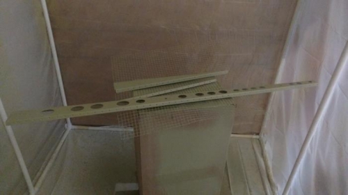

Rudder Spar primed on my
Rudder Spar primed on my "spray box"

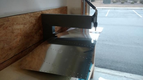

Dimpled rudder skin
Dimpled rudder skin
