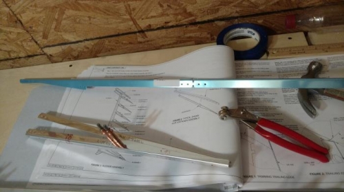

I continued on with the rudder today, since I'm at a stopping point with the vertical stabilizer. There are several two-piece triangle stiffeners that I've had to break apart and trim to fit the tips together. Since I don't have a band saw, I used a coarse grinding wheel. In doing so, one side of a stiffener tip got caught in the grinding wheel, bent, and cracked. Unusable....

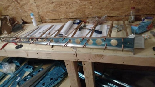

So, there's a third piece for me to replace. I went ahead and marked it as "DO NOT USE", then continued to cleko the rudder together to get an idea where the steps were taking me. It's fun seeing all these 2-D strips become 3-D.

One piece becoming two for stiffeners
Stiffeners cleko'd to rudder spar
